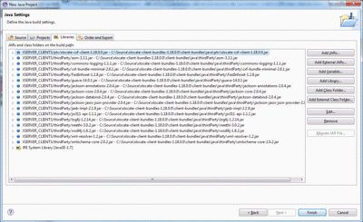

On the "Java Settings" page, directly navigate to the "Libraries" tab where we need to add the JAR files required by our project:
- Call "Add Variable", select "XSERVER_CLIENTS", press "Extend", expand "ptv", select "<xlocate-jar>" and press "OK"
(depending on the version of the client classes, "<xlocate-jar>" may differ) - Call "Add Variable" again, select "XSERVER_CLIENTS", press "Extend", expand "thirdParty", select all jars below that node and press OK.
