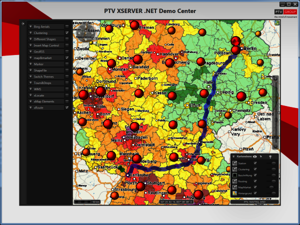

Together with the xServer .NET SDK, an interactive demo center is installed. The Demo Center is a sample program illustrating typical scenarios and use cases of PTV xServer applications: map visualisations, routing, trip planning etc. The Demo Center is only available for API Version 1. The source code of the Demo Center is included in the SDK for the retracing of the implementation.
